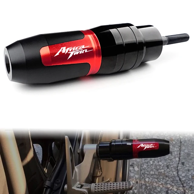

I just ordered mirrors extenders, a protector for the exhaust on case a fall to the right, a key ring, and a Sae connector for the battery, other set of fog lights brackets, and last a fender extender. :ROFLMAO: :ROFLMAO: :ROFLMAO:

WHich protector for exhaust. link please.
