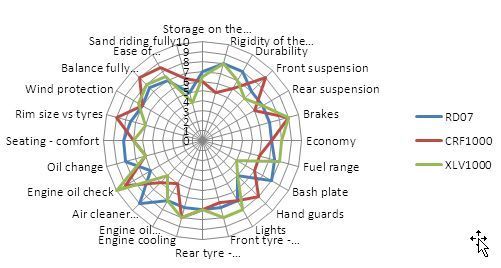

The CRF came with a LOT of hype. Excellently priced (In Australia its cheaper than both the 800 Tiger and 800GS range) and well received. Unfortunately, the price comes at a price. Now the RD07 was never a ‘cheap’ bike, and for a little more you could get a large beamer. But the bike was excellent quality and robust. Sure, not bulletproof like some say it is, and some known problems include a crappy fuel pump, too soft light carrier frame that cracked and electrical connections that eroded and could cost you hundreds to repair if it fried your ICU or worse. And in my experience, my AT only ever once came home on a trailer when it blew out a sparkplug and almost all problems could be related back to shotty maintenance or the like.
So back to CRF- having now done a few thousand km on the beast, I have come to the conclusion it may not be as good as the old RD07. Don’t get me wrong: I love the bike. When riding it ‘empty’, its better than the RD07 in every form. But as a world traveller, I reckon it’s got a way to go to unseat the legend. I’ve scored the CRF against the RD07 on various points important to me. Then I added the XLV1000 Varadero for good measure because it’s actually a V-twin and I thought the engine characteristics would be valuable. I will discuss some of the issues below. It was a bit hard to break the diagram into pure categories, such as maintenance, performance etc, but I tried to keep it as close as possible.
Also, I have not ‘strictly’ included a standard RD07. Very few touring bikes will still be standard, but I tried to keep it relevant to standard mods most people would have done by now. But for the sake of this exercise, the RD07 includes:

I bought my Africa Twin secondhand in 2002 after missing the final roll-out of the RD07 when Honda decided to discontinue the legend. I bought a 2007 model, with 42k on the clock and for more than you could buy a new KLR650. Back then I thought I might have made a mistake, and taking “The Legend” for its 1st ride I was not all that impressed. But within a few months, I realised it was the right choice and 15 years and over 200k later, I know why it’s a legend.
Ever since then, every bike I have ridden and/or owned, I have compared to the AT and judge it as a possible replacement for the workhorse. Top of the list was the 950/990 KTM, but reliability and maintenance cost always put me off. Then came the 800GS, and although the bikes are good, sad to say the build quality is not there (replacing steering head bearings after <70k is poor build to me). Tiger 800- what a great machine, but difficult maintenance and longevity question marks shadowed its future (Any bike with crashbars mounted onto the engine needs some serious rethinking).

Also to compare apples with apples, I used exactly the same panniers on both Africa Twins, but the XLV1000 is equipped with SWM panniers, but other than included as ‘standard’ with no mods.

Conclusion:
So what makes a legend? Other manufacturers had good bikes and tried, like the Super Tenere and the Cagiva Elephant. But I believe the Africa Twin became a legend because of its build quality and what you could do with it. The new CRF may be a better, cheaper bike than the old XRV-range, but sadly, I can’t see it topple the old Africa Twin from its pedestal. So am I disappointed in the CRF – no, not at all. But I will also not retire the RD07, because if I have to pick a bike today, now to leave on a cross-continental trip, the RD07 would still be my 1st choice above the new CRF.
