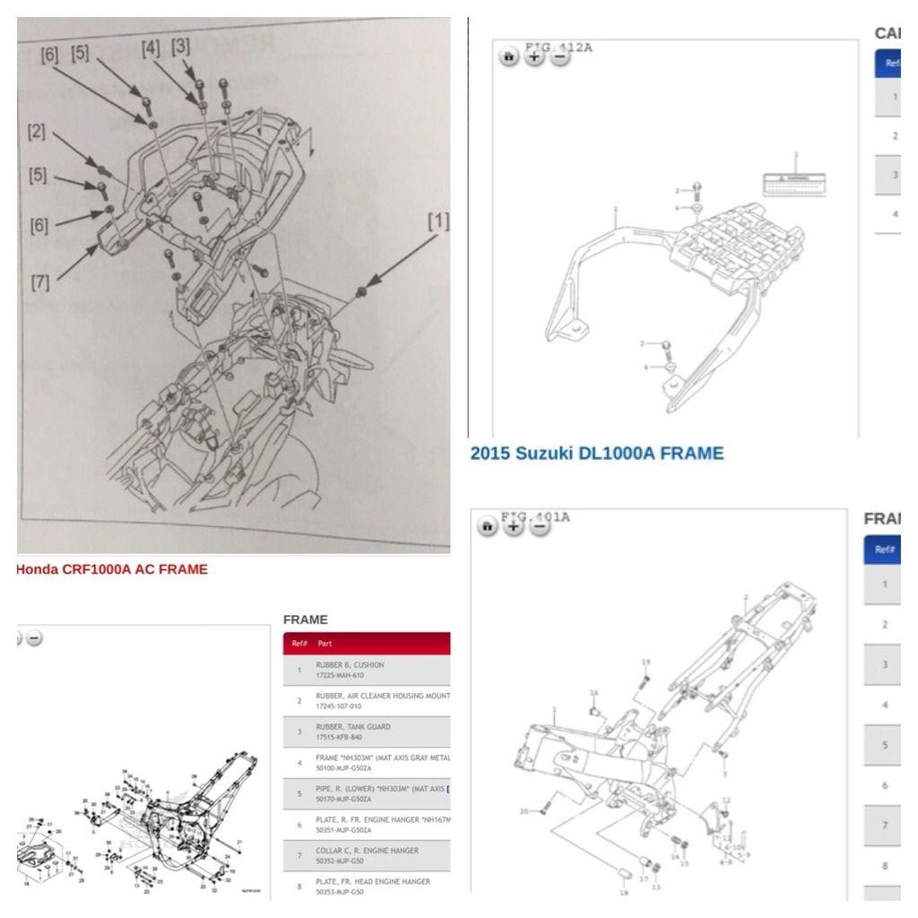

Wow,made from steel yet still broke under the top box while off-road:
pathetic
The steel subframe broke or just all the plastic bolted to it?made from steel yet still broke under the top box while off-road:
https://www.youtube.com/watch?v=CjHWJFrly24
pathetic
looks like steel subframe because honda agreed finally to weld it for the guy.The steel subframe broke or just all the plastic bolted to it?
Fake New ;-)made from steel yet still broke under the top box while off-road:
pathetic
I figured it was the plastic and not the subframe. I've done the LA-Barstow-2-Las Vegas event on an ADV bike and I'm not surprised it broke with the weight of the top box, especially mounted that far back.Fake New ;-)
What broke is the plastic craddle. Not the rear frame. What wasn't mentioned by the rider is that he did an enduro in the desert a week prior, and had his loaded top box fitted. ;-)
Barstow to Vegas
That's terrible. It's amazing someone could make a video like the original one knowing they had a direct part in breaking it. I used to work at a bike shop and have heard so many "JRA stories" (I was just riding along and ...) Adults take responsibility for their actions, kids blame.Fake New ;-)
Barstow to Vegas
https://www.youtube.com/watch?v=90fUKlvkI-o
Well. Go to a Honda dealer and bring a magnet. Try to make your magnet stick to the rear rack. You'll see if it is plastic or steel. ;-)If it was plastic craddle how come honda offered him to weld it?
