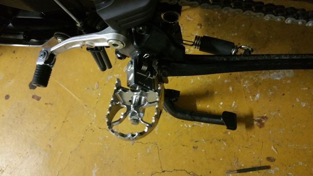

quick question...
Pivot pegs are of course, great, as are fastway!!
just wondering if there's an alternative option...for example "AT uses same attachment fitment as XR650L or crf450, etc...?
OR an option like these in the pic below... I replaced stock KLR pegs with these about 8 years ago and they are still going strong and work great!
