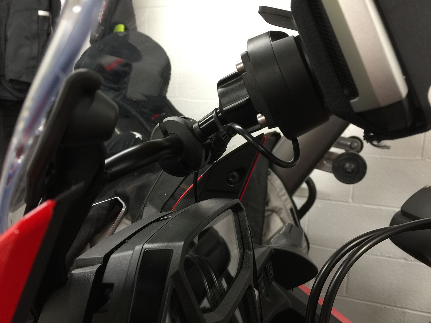

I just used a standard "mirror stem GPS mount" to mount my Tom Tom, and fits fine. 1400 miles and solid.
Simple clamp
Central position
Perfect view
