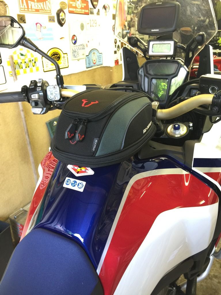

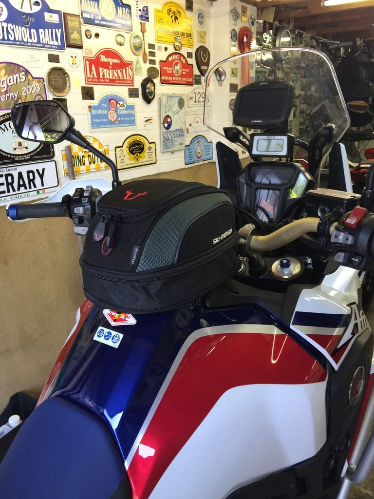

Sorry it's not a very good picture, but this is the SW Micro tank bag, I thought it maybe to small but its just the right size for what I have in mind, it expands another couple of inches,
I find it's great for my camera, wallet, phone, a spare pair of summer gloves and my visor cleaning stuff,

The adaptor plate that fits underneath the bag, you can position it where you like, the best position is where shown, this way it doesn't interfere with the steering or switches in any way,
