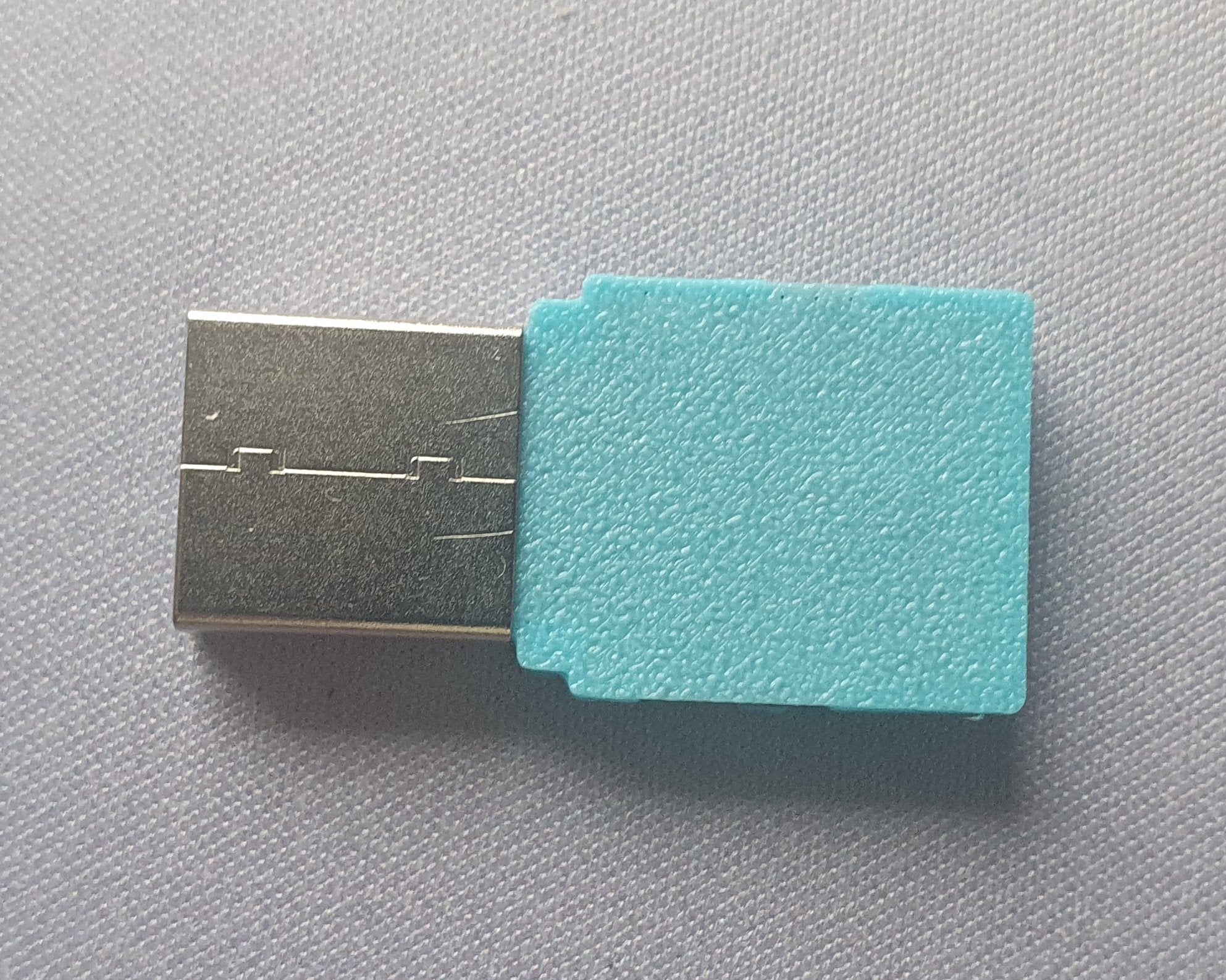

I though, ok let's go by wifi using a dongle, I bought this, it's the smallest and compatible with Android an IOS: Carlinkit Mini Se Pro Dongle inalámbrico CarPlay - Carlinkit Factory España (only pro version allows ios+android).
As soon as I received I saw that if I connect it directy, even it's a small device it will impact to the handlebar at max turn.

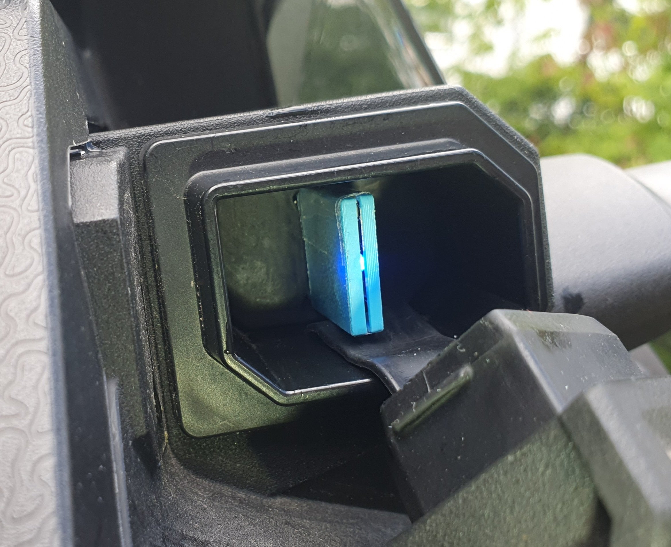

With a 2m usb data cable https://es.aliexpress.com/item/3260...tml?spm=a2g0o.order_list.order_list_main.22.35a7194daPEQgx&gatewayAdapt=glo2esp, I passed the cable from the behind of the bike, through the plastics until under the passenger seat.
You have to open not even remove a couple of plastics, side one (under the tank) with allen key and a plastic clamp, for sure both seats, and finally in the front part just lift a bit the plastic and you will be able to guide the cable internally. I started passing first from the front where the chasis/fork it's placed to the back, and then I passed the usb male from the "bottom" to the top, the rubber that have the Africa it already have kind of hole at right side to allow the cable exit, then I connected the dongle and protected to the water or dust.
Now, as soon as I start the bike (10s) the apple car starts, automatically it connects with my phone, it's not visible, it can't be stolen, it's in a secure place, if I want to disconnect for some reason it's as easy as remove the passenger seat and disconnect (bike software update for example).
