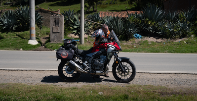

Poor little CB500x, flogged to the max:
[IMG]
